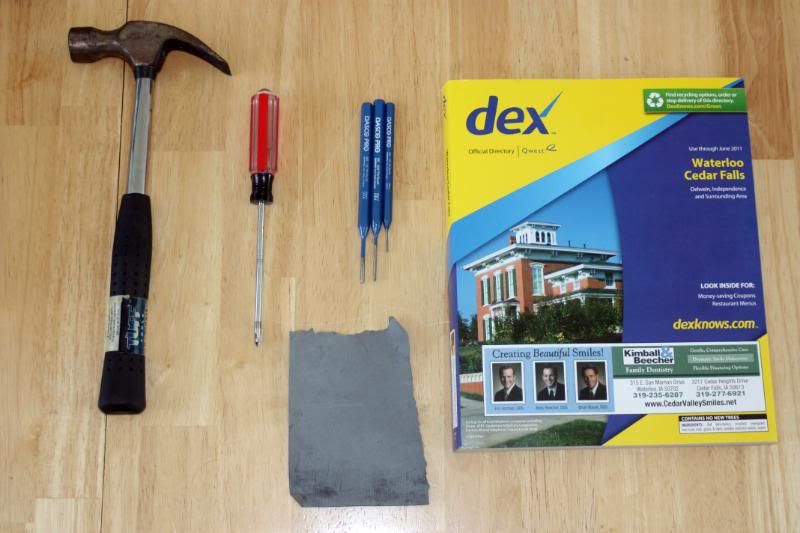

Alright to start off the tools you are going to need:
Hammer
1/16 punch
3/32 punch
1/8 punch (optional)
Phillips screwdriver
Phone book or soft surface
Between 600-3000 grit sand paper.

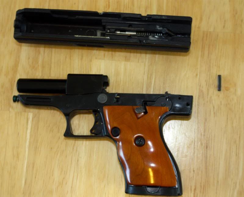

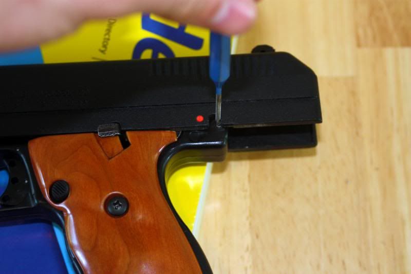

Alright to start off pull the slide back and lock it in place with the safety. Now put your C9 on the phone book and take the 3/32 punch and hammer and remove the pin that holds the slide in place.
DIY: Customizable trigger job - Hi-Point Pistols
Now take the slide and the pin and sit them off to the side. Do not tip the slide as the mainspring and firing pin my fall out or just remove them and set them with the slide.

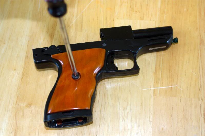

Now take the Phillips screwdriver and remove the grip on the right side of the gun or the side opposite to the mag release button.

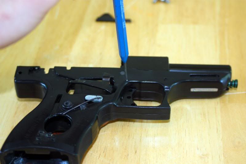

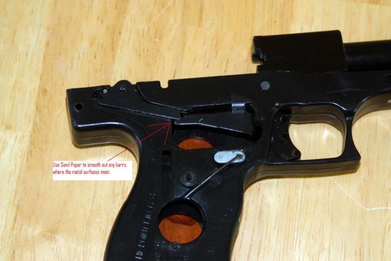

Now remove the sear and sear spring and set them off to the side and remove the metal peice shown in the last picture if you haven't already.

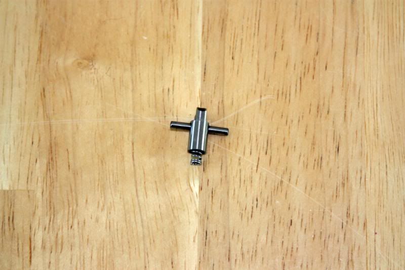

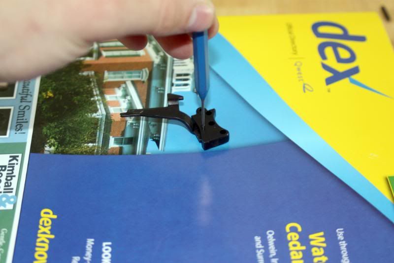

Now take the 1/16 punch and hammer and find the pin above the trigger that holds the trigger assembly in the gun and tap out the pin to remove the trigger. It will still have a piece of metal on it at this time.
This is what you will have removed

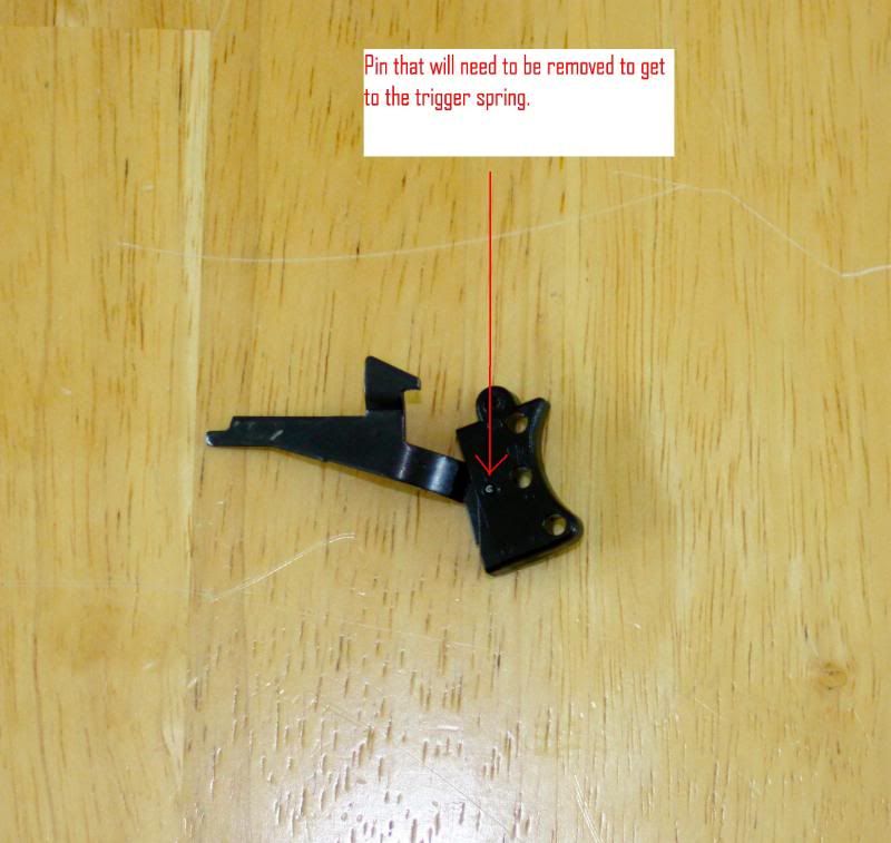

Now take the 1/16 punch and remove the little pin that holds the metal piece to the trigger itself.

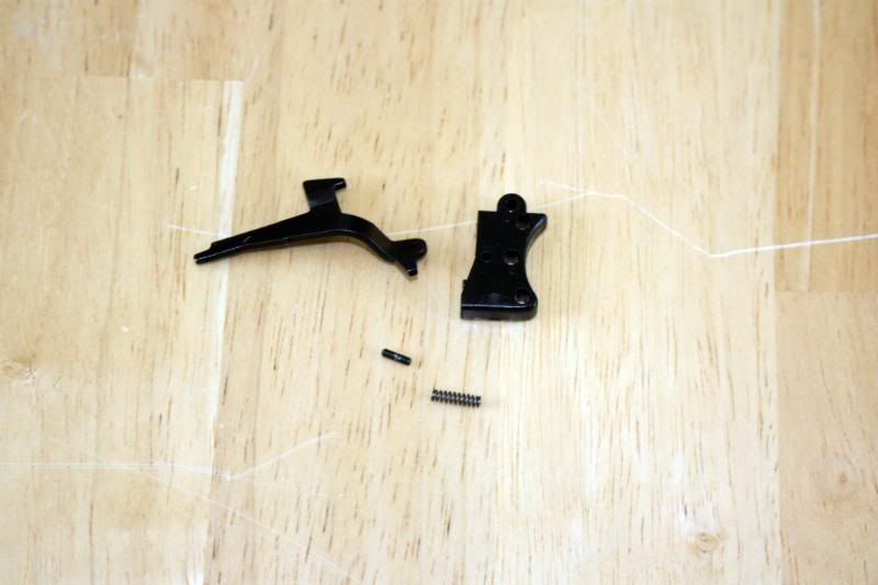

Here are all the peices you should have when you remove and tear down the trigger assembly

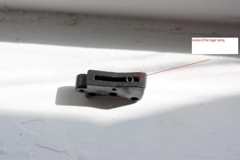

The trigger spring should be located in the trigger in a hole made to seat the spring.
Now remove the spring if it has not already came out and replace this spring with a lighter spring of your liking. This alone will improve the trigger pull but works best in combination with the other mods. Now do not cut the spring and only replace it with a light spring of the same lenght.
Now onto the sear and sear spring, I personally sanded all of the sear with 3000 grit sand paper but that is not something you have to do and does not improve the pull much. The part you mod here again is the spring some people cut down the sear spring but that does not really help the trigger pull it just makes the trigger pull shorter and can be unsafe. Now when replacing the sear spring be careful not to go to light as it can cause accidental discharges, injury, or uncontrollable firing. I found a spring that was 3/4 strength of the original spring and it seems to work very well but this is something you will have to test.

The only part of this I would recommend would be removing the sharp edges from the back of the sear and trigger levers. A shorter or weaker spring under the sear will not engage the sear as deeply into the firing pin, and without a block safety...
