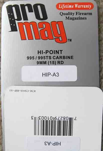

Originally Posted by crusty_CCT View Post
And I had no idea there were 2 versions of the same model number!!!! That's ridiculous! Are they retarded? Why the hell would a company do that? Isn't the whole point of making a change that's beneficial to put it out under a new name to let consumers know at a glance that it's the latest, updated version? Bollocks.
Here's my pic of my promag packaging. To see many pictures of my Promag A3 rev 1 follower look at the sticky thread.
Yup, pretty crappy revision control procedures at that company. If you can't do that right can a person expect them to really fix the problem?
PS I love the "Lfetime Warranty Quality Firearm Magazines " blurb. NOT.

Clearly they should have hired you or I, lol. Hats off to you for 35 years of engineering, sir. Thanks for paving the way for youngins like myself. Although when I graduated from college in Jan '04 I immediately when to USAF OCS in Feb '04, I haven't really used my degree all that much, but I love my job, my branch, and my country. Oh, and my guns, lol.
