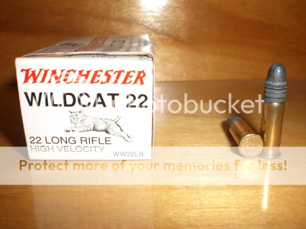

WINCHESTER WILDCAT
40 gr LRN
average group size 1.67"
velocity
factory spec 1255 FPS
average 10 rd string 1251
low 1240 high 1261
notes
Basic average ammo. Good velocity window, good groups.
cost 1.99/50

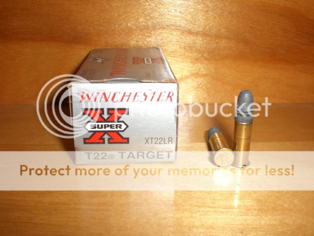

WINCHESTER T22 TARGET
40 gr LRN
average group size .90"
velocity
factory spec 1150 FPS
average 10 rd string 1132
low 1105 high 1159
Winchesters mid-range target ammo delivered good groups although the velocity variation was more than id like for a target ammo. slightly dirty but not bad at all.
cost 9.99/50

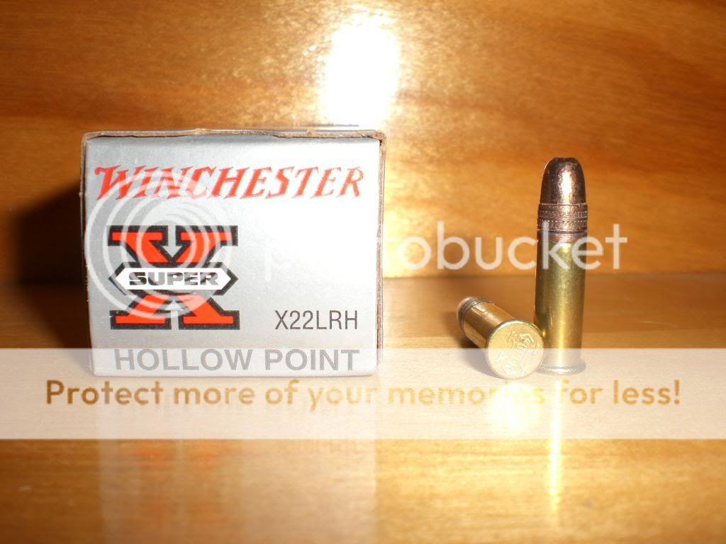

WINCHESTER SUPER-X HOLLOW POINT
37 gr HP
average group size 1.10"
velocity
factory spec 1280 FPS
average 10 rd string 1295 FPS
low 1275 high 1305
Good overall ammo, a littel dirty and a few cases extracted hard. one round in the box had a canted bullet and was discarded.
cost 2.86/50

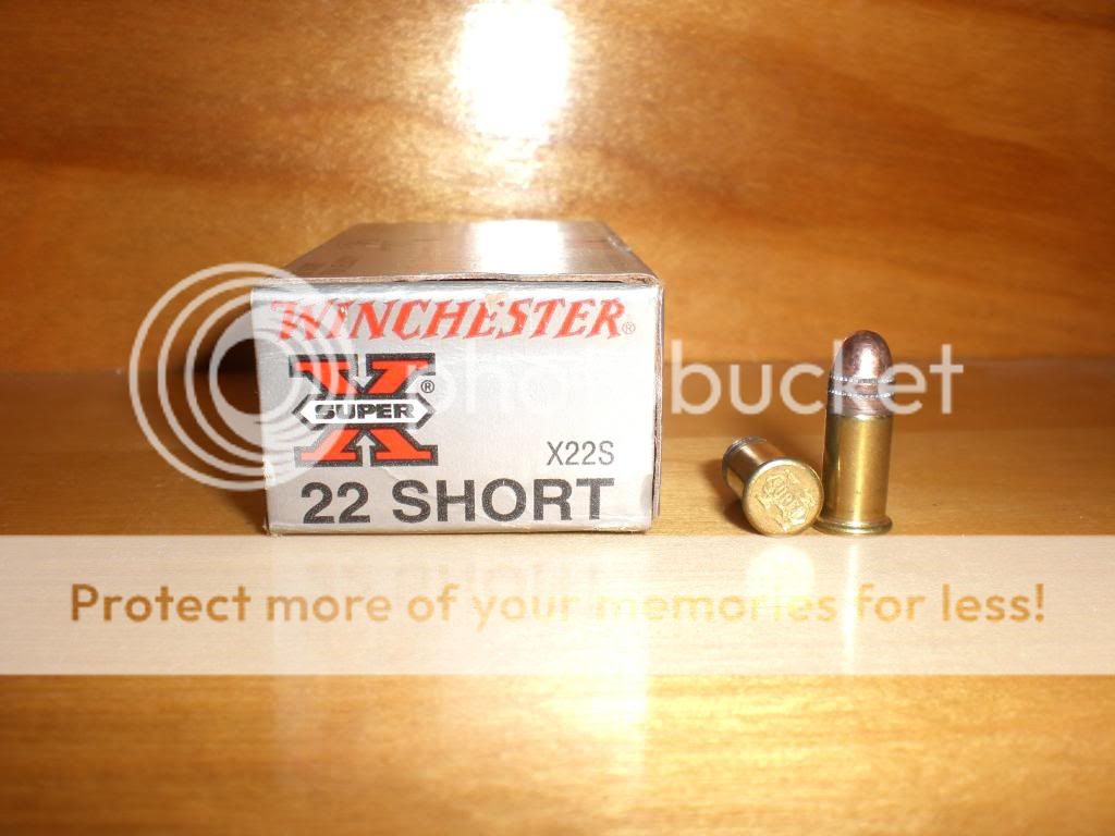

WINCHESTER SUPER X SHORT
29 gr lead round nose
average group size 1.30"
velocity
factory spec 1085
average 10 rd string 1081
low 1070 high 1094
notes
the most accuracte short ive tested yet. smooth shooting and very clean. definantly a top contender in the short category.
cost 4.08/50

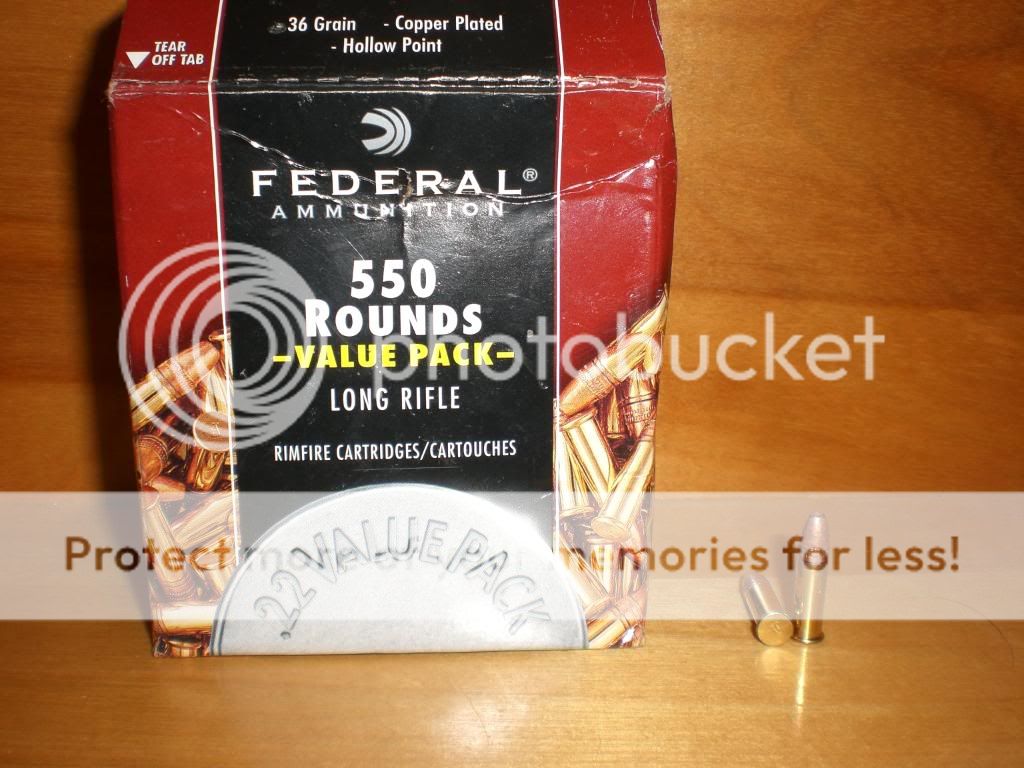

FEDERAL VALUE PACK 550 RD
36 gr copper plated HP
average group size 1.70"
velocity
factory spec 1260 FPD
average 10 rd string 1244 FPS
low 1224 high 1269
notes
This is the most common bulk pack ammo in Wal-mart. Ive shot literal piles of
this stuff through a 10/22 with few problems past the occasional squib. i have
found a few empty cases in the boxes that QC missed but overall its good stuff. a
little dirty but not too bad.
15.99/550

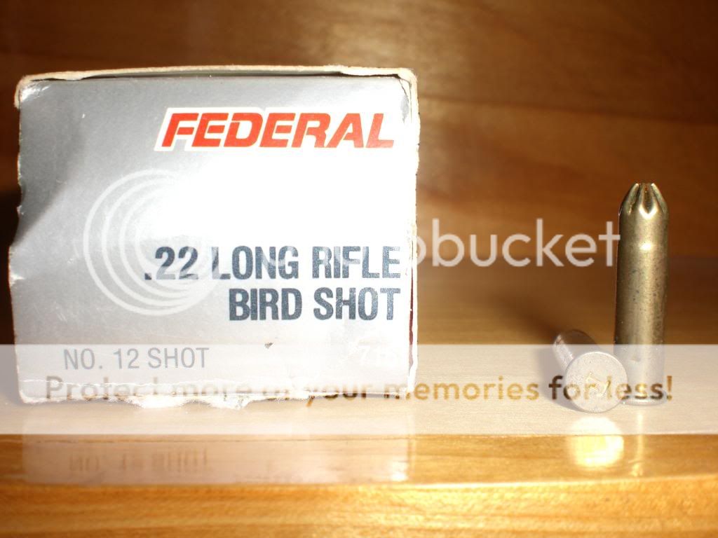

FEDREAL LONG RIFLE BIRD SHOT
25 grs of #12 shot
velocity
no factory spec
didnt register on my chrono
did this the same as winchester ammo for group sizes at distance
group size at 3' - 3"
group size at 5' - 5"
group size at 8' - 10"
group size at 10' - 20"
Left several chunks of debris in the barrel, i think they were part of the wadding
in between the shot and powder charge. I had to clean them out with a brush
before contiunuing the test.
cost 8.95/40

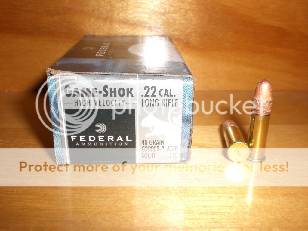

GAME SHOK
40 grn lead RN copper plated
average group size 1.35"
velocity
factory spec 1260 FPS
average/10 rd string 1245 FPS
high 1270 low 1225
notes:
extremly smoky with lots of unburnt powder left in the barrel. also left a funky ring of gunk around the chamber face of my rifle.
cost 1.95/50

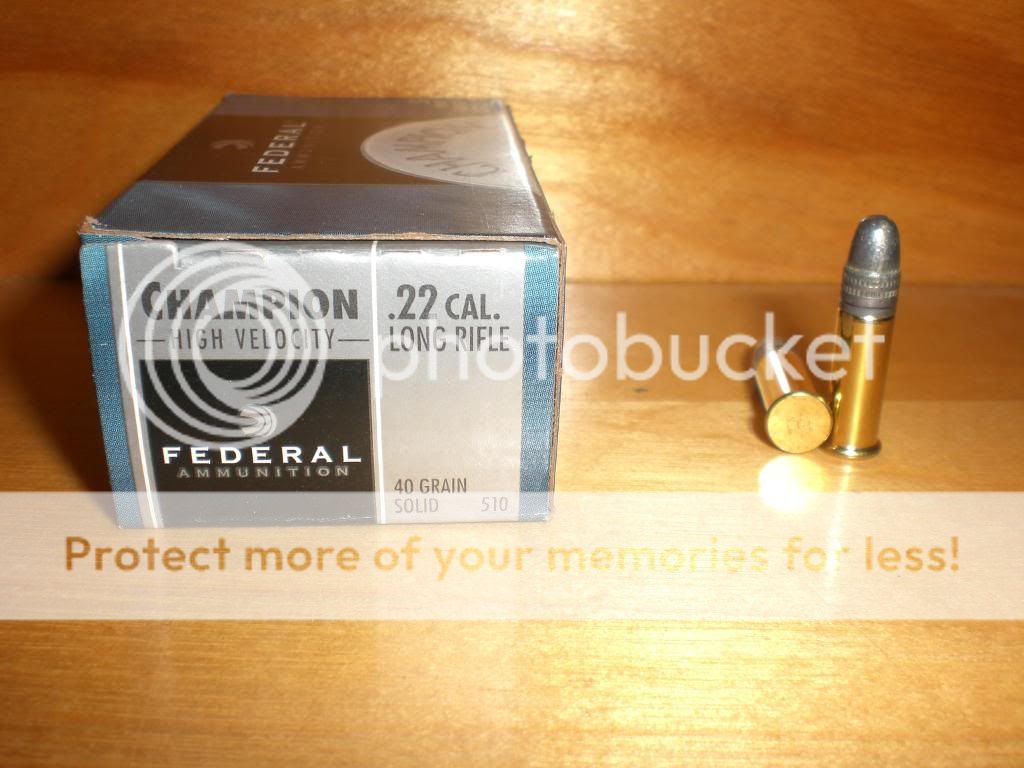

CHAMPION HIGH VELOCITY
40gr LRN
velocity
average/10 rd string 1310 FPS
high 1342 low 1250
notes:
very littel smoke but left lots of unburned powder in the barrel. needed two passes with a bore mop to clean it out.
cost 1.85/50

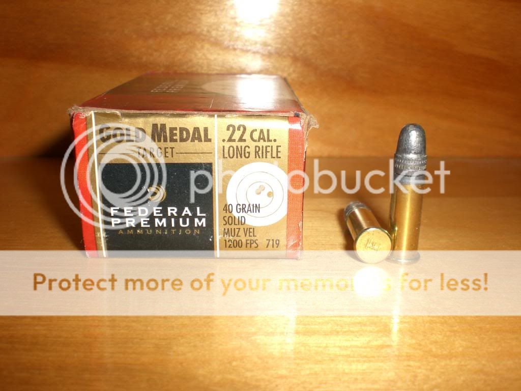

GOLD MEDAL TARGET
40 gr LRN
average group size 1.20"
velocity
factory spec 1200 FPS
average/10 rd string 1205 FPS
low 1194 high 1210
Notes:
VERY clean shooting, almost no residue at all. also was a sweet smell after firing. i had high expectations of this ammo and it didnt let me down. delivered the tightest groups of the night and the smoothest ejection of the spent casing as well.
cost 5.95/50

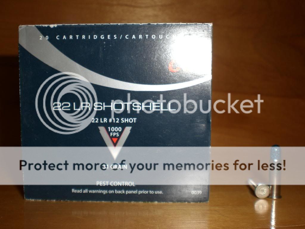

CCI #12 ENCAPSULATED SHOT
31 gs of #12 shor
velocity
factory 1000 FPS
did not register on my chrono
did this the same as the winchester ammo for group sizes at distance
group size at 3' - 2.5"
group size at 5' - 4"
group size at 8' - 8"
group size at 10' - 13"
a littel dirty but not too bad, will not cycle semi auto
11.90/20

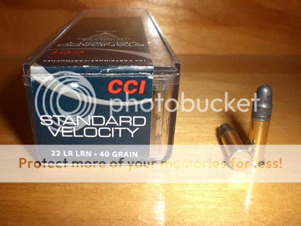

CCI STANDARD VELOCITY
40 gr LRN
average group size 1.65"
velocity
factory spec 1070 FPS
average/10 rd string 1006 FPS
high 1050 low 992
notes
while varitions in velocity hurt this round it shot above average groups for the day. it also shot VERY cleanly with no smoke and little residue in teh bore.
6.50/100

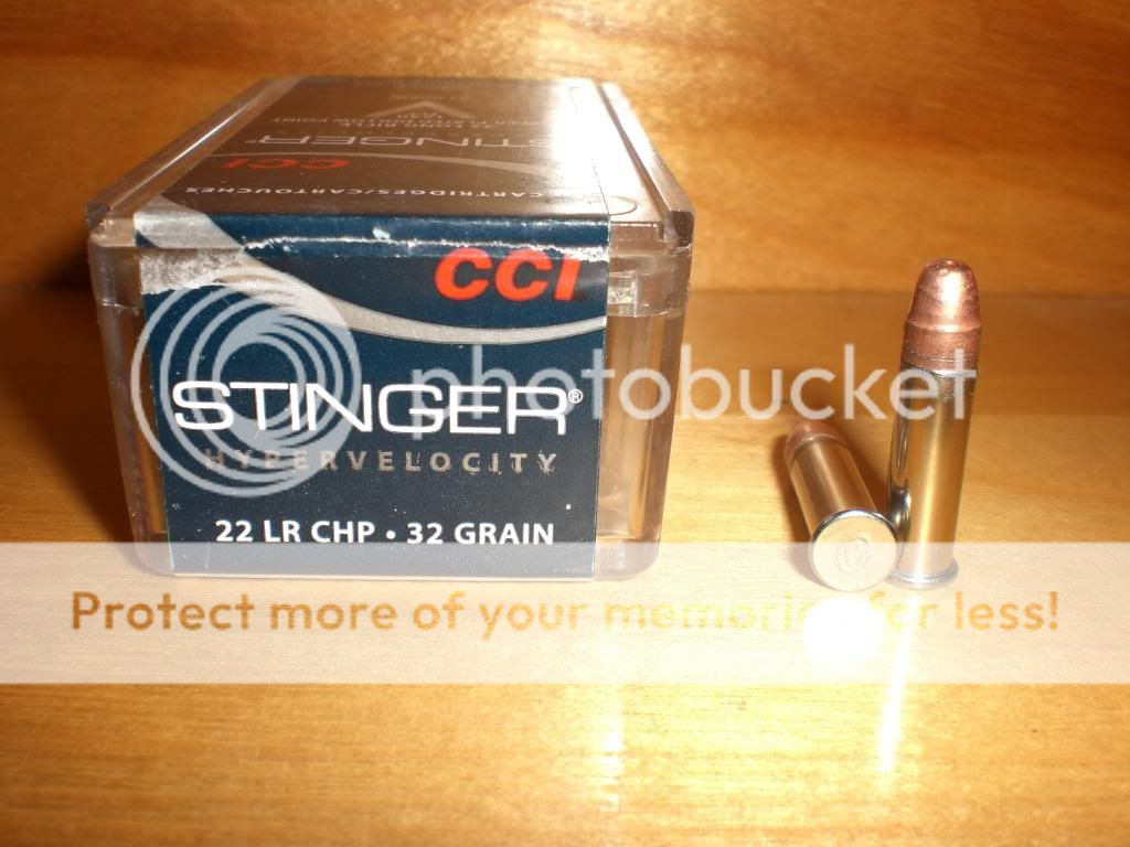

CCI STINGER
32 gr copper plated HP
velocity
factory spec 1640 FPS
average 10 rd string 1675 FPS
high 1701 low 1650
notes
I have ALOT of expierence with this round as its my primary CCW fodder for my beretta 21A and PK-22. it relaibly cycles small autos and feeds and functions 99.9%. velocity variations didnt seem to hamper this rounds accuracy and it was very smooth and clean shooting, well worth the high price tag.
9.75/50

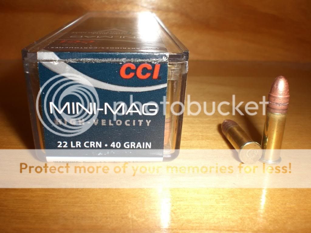

CCI MINIMAG
40 gr copper plated LRN
velocity
factory spec 1235 FPS
average/10 rd string 1105
high 1115 low 1100
notes
this ammo was a complete failure to meet specs posted on CCIs webiste and on the box. the rounds had low power and inconsistent ignition for something marked "minimag". also velocity was WAY off of what they called for.
cost 6.99/100

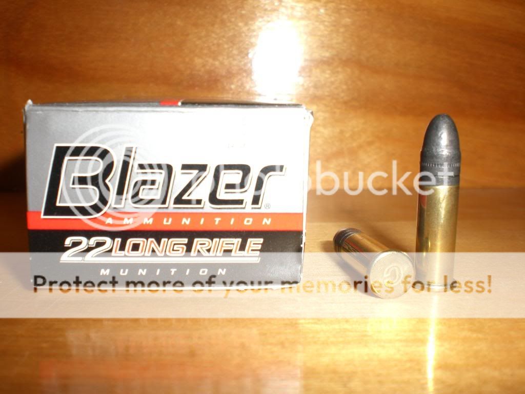

CCI BLAZER
40 gr LRN
average group size 2.55
velocity
factory spec -i wasnt able to find any spec on the product box or on CCIs website-
average 10/rd string 970
low 755 high 1106
notes
all i can say about this stuff is DONT WASTE YOUR MONEY! it shoots extremely inconsitent veolcities and groups. half of the first group i shot were off the paper and i had to start over with a totally different aimpoint from any other ammo. It is VERY dirty and left a thick black ring of gunk around the muzzle. the only thing this stuff is good for is a bullet hose like my Ruger 10/42 conversion or a full auto rimfire conversion. there was also a strange smell after firing that vaugly reminded me of cattle urine or some cleaners ive been around. at this time i cannot reccomend buying this ammo at all and it currently resides in dead last for quality.
cost 1.99/50

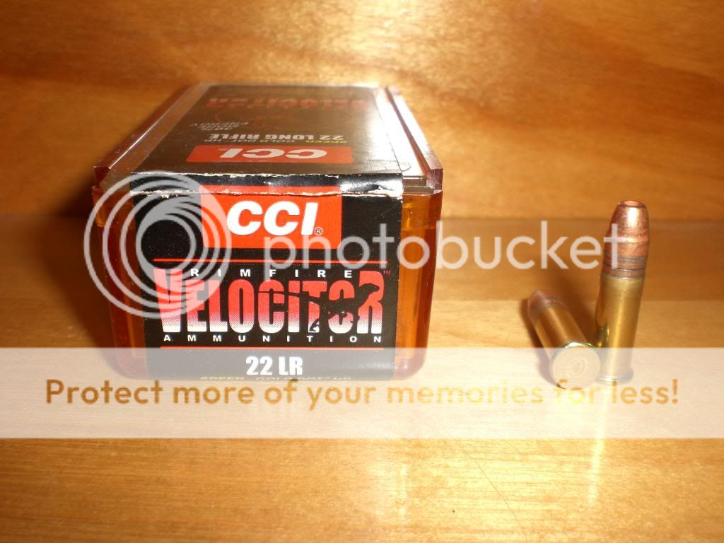

CCI VELOCITOR
40 gr Speer Gold Dot HP
average group size 1.05"
velocity
factory spec 1435 FPS
average/10 rd string 1429 FPS
high 1439 low 1425
I expected plenty from this ammo as ive shot tons of praire dogs with it. It didnt let me down. Clean shooting, smooth ejection and very little smoke make this a top notch round. It does have a loud muzzle blast that will ring your ears if you're not wearing hearing protection.

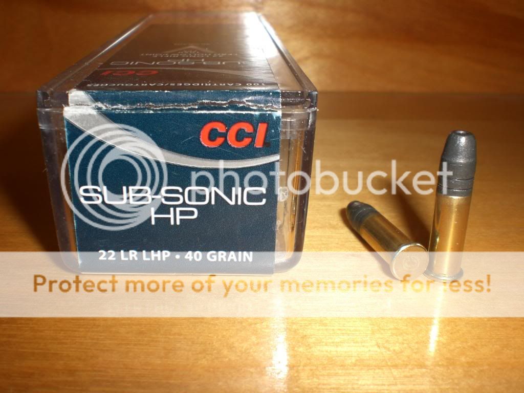

CCI SUBSONIC HP
40 gr lead hollow point
velocity
factory spec 1050 FPS
average 10 rd string 1034 FPS
low 1044 high 1070
notes
lots of unburned powder int he bore but otherwise clean shooting.
cost 3.99/50

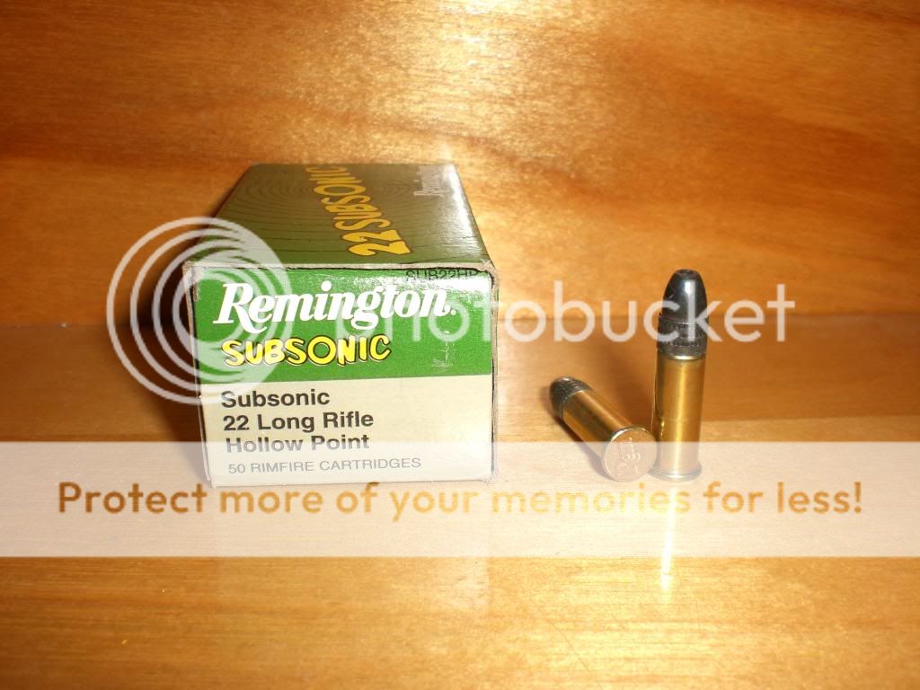

REMINGTON SUBSONIC
38 gr lead round nose
average group size 2.05"
velocity
average 10 rd string 1055 FPS
low 1040 high 1076
notes
VERY smokey and stinky ammo. had one round that was an apprent overcharge as it was WAY hotter than the rest at about 1200 FPS. i discounted it from testing numbers but noted it here.
cost 2.78/50

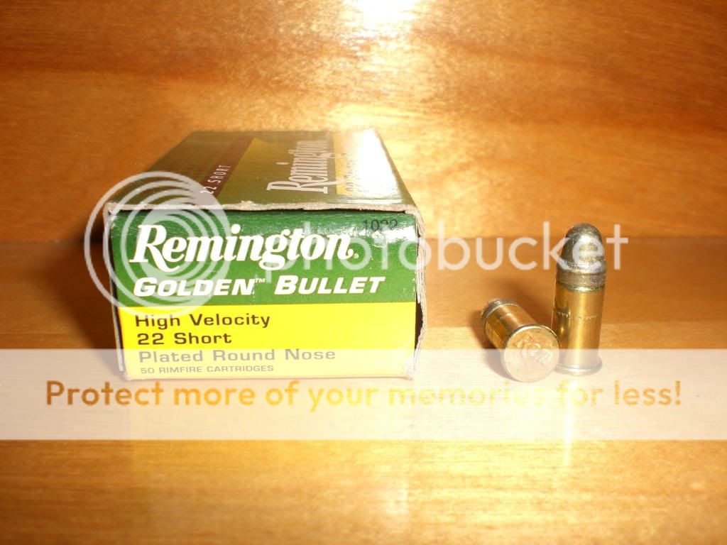

REMINGTON GOLDEN BULLET SHORT
29 gr brass plated round nose
average group size 2.45"
velocity
factory spec 1095 FPS
average 10 rd string 1101 FPS
low 1049 high 1105
notes
upon opening the box found several cases with deformed rims that wouldnt chamber. also a couple rounds had canted bullets. all were discarded. otherwise clean shooting.
cost 5.95/50

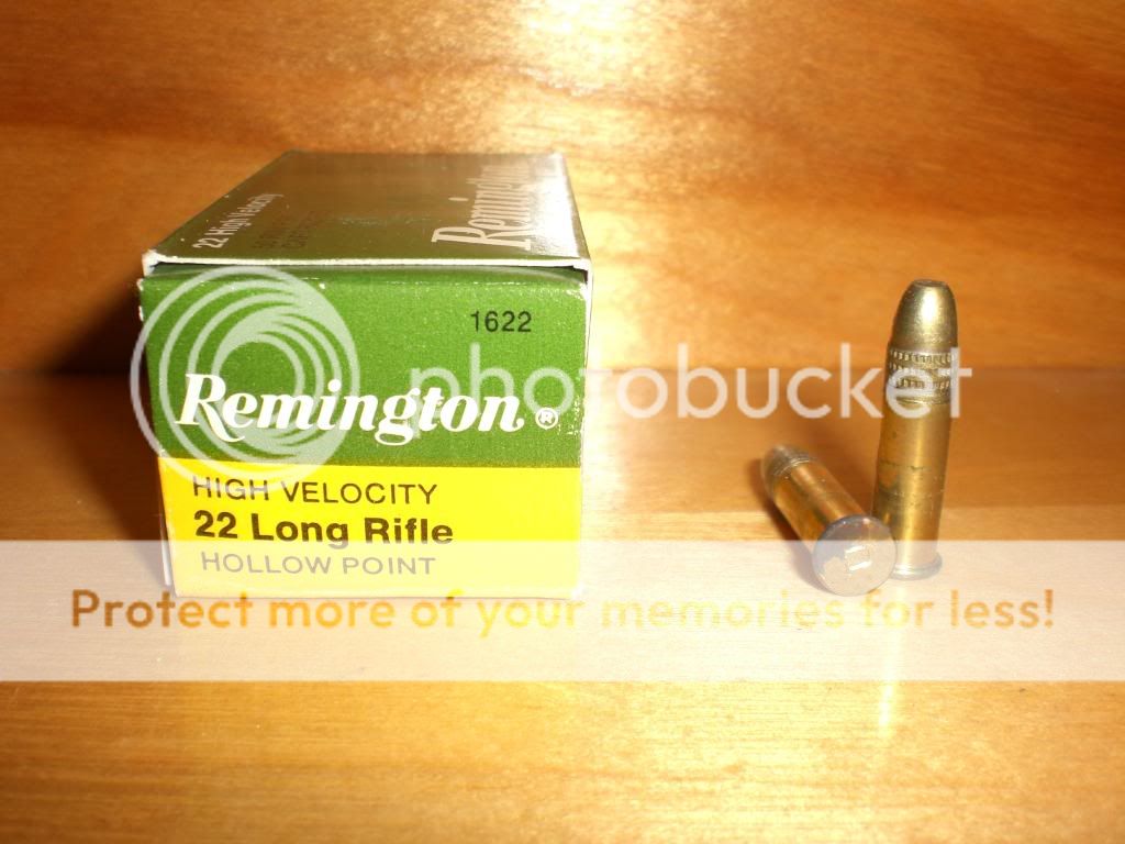

REMINGTON HIGH VELOCITY HP
36 gr brass plated HP
average group size 1.25
velocity
average 10 rd string 1210 FPS
low 1187 high 1260
notes
this ammo is no longer manufactured by remington and i found it in a mom and pop gunshop discount bin in a small town i service. the rounds came out of the box tarnished and the bullets had a heavy waxy coating. as they are not current manufacture we will discount them from the overall test but add them in for comparison purposes only. the ammo was very smokey and had a pungent, sharp peppery smell when fired.
cost .99/50

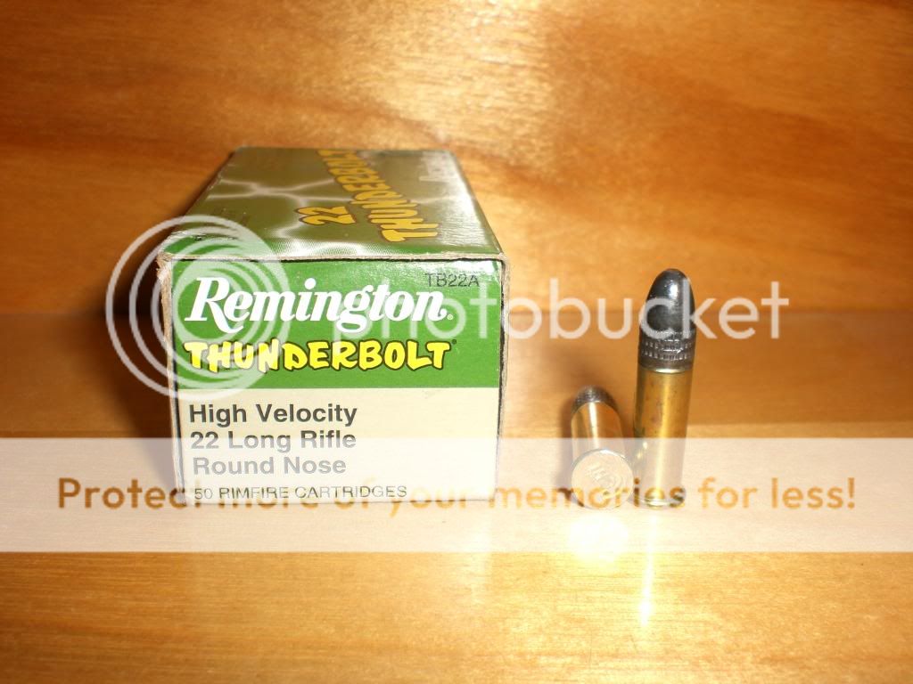

REMINGTON THUNDERBOLT HP
40 gr lead round nose
average groups size 2.26"
velocity
factory spec 1017 FPS
average 10 rd string 1025 FPS
low 1010 high 1040 - one squib load at 775 FPS discounted
notes
smokey and also had a couple squibs with this ammo. one bullet didnt even leave the barrel of my rifle. the other was a couple feet off target. most of the other rounds seemed inconsistent in power but velocity numbers were fairly tight.
cost 3.95/50

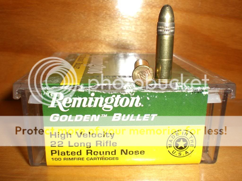

comes in bulk packs as well as 100 round packs
40 gr LRN copper plated
average group size 2.10"
velocity
average/10 round string 1230 FPS
high 1278 low 1201
notes EXTREMELY DIRTY. left a heavy "lube star" on the muzzle and plenty of unburned powder and gunk in the barrel. had to stop for a full cleaning at this point as the fouling would have thrown off further tests.
cost 6.95/100

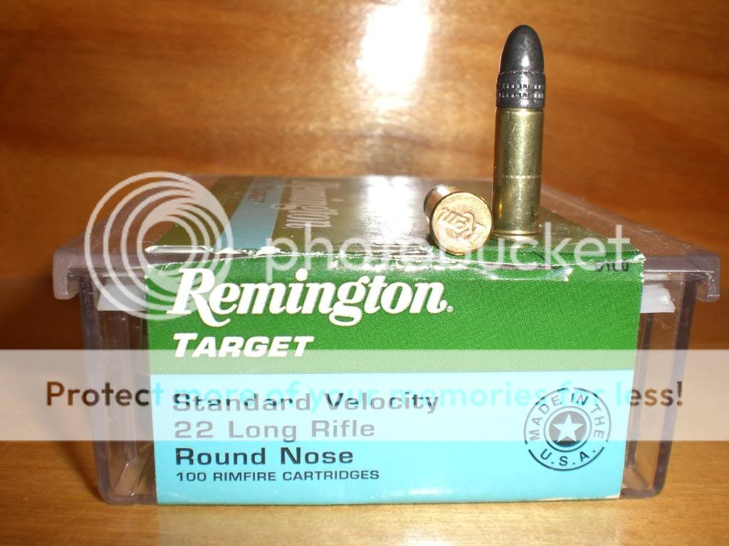

REMINGTON 'BLUE BOX' TARGET
40 gr LRN
average group size 1.75
velocity
average/10 rd string 1132 FPS
high 1187 low 1120
notes
Very little fouling or smoke, clean shooting. there was some kind of shiny coating on the bullet that i could mar with a fingernail, im assuming it is some kind of lube, possibly wax based. with poor accuracy this doesnt rate the target ammo cost, and doesnt meet target ammo standards for me.
cost 11.95/100

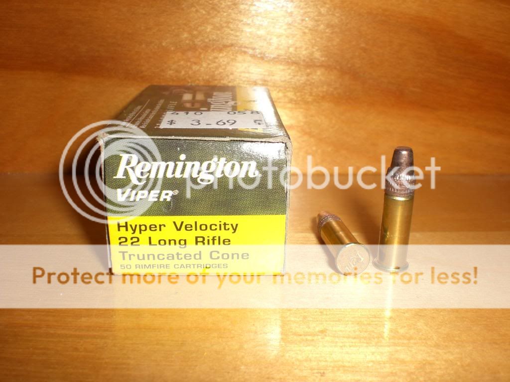

REMINGTON VIPER HYPER VELOCITY
36 gr truncated cone flat point
average group size 2.50"
velocity
factory spec 1410 FPS
average/10 rd string 1401 FPS
high 1405 low 1389
cost 2.85/50
notes
the first thing in noticed about these when i took them out of the box was very inconsistent bullet manufacture. the bearing bands of the bullet were peened onto the truncated bullet nose in varying degrees and not consistently around the bullet. I have plans to call remy on this one to see if this is the way its supposed to be or if these are mis-manufactured. i feel this inconsistent bullet mfg hurt the accuracy potential of these. a re-test may be needed depending on what remy says. they were also very dirty to shoot with LOTS of smoke and some barrel fouling.
added note. i spoke to remy customer service on the bullet problem and the lady on the phone said she would look into it and get back to me. that was two months ago and i never got a call back. Accuracy test stands as i looked at a different lot of these rounds and the peening was still there.

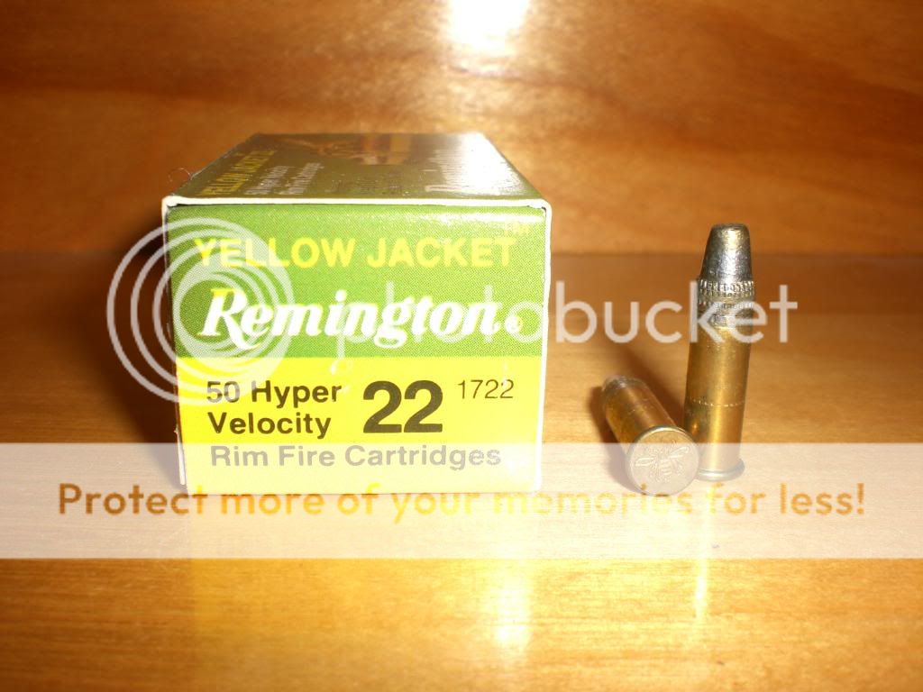

REMINGTON YELLOW JACKET HYPER VELOCITY
33 gr truncated hollow point
average group size 1.34"
velocity
factory spec 1500 FPS
average/10 rd string 1505 FPS
high 1510 low 1500
3.99/50
notes
VERY tight velocity window on this round helped it stand out from the pack. i feel it also contributed to above average accuracy. the rounds are clean shooting and i alos noticed they seemed to be a slightly tighter fit in the chamber vs others. I had no ejection problems at all. they also feature a neat headstamp (il post pics later) integrating the remington "R" and a stylized insect. low cost and good accuracy make this a good bang for your buck buy.
cost 3.75/50

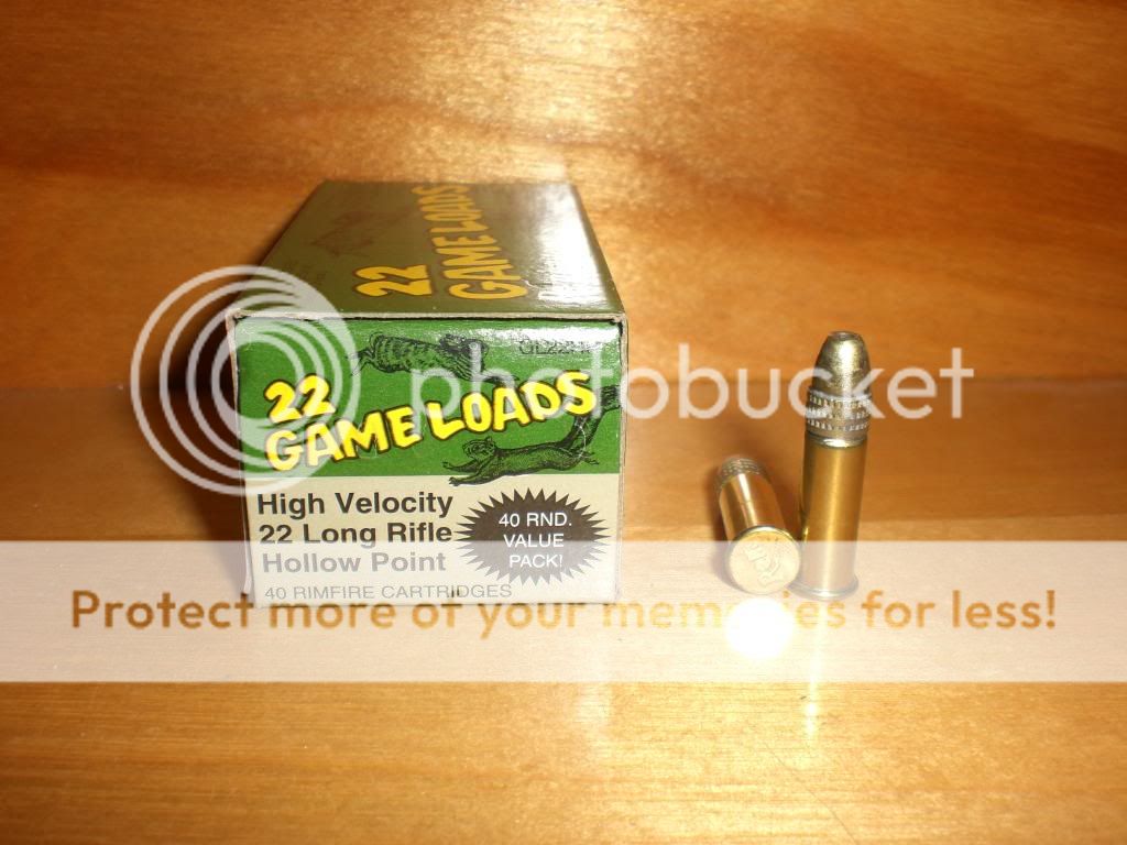

REMINGTON "GAME LOADS" HIGH VELOCITY
36 gr lead hollow point
averagr group size 1.00"
velocity
average 10 rd string 1278 FPS
high 1282 low 1275
notes
This round was a complete surprise back-of-the-pack winner. Less than 10 FPS deviation and consistent bullets gave it a decidedly excelent rating. Very clean shooting and consistent. Did i mention it was consistent? Best bank for the buck so far.
Cost 1.75/40

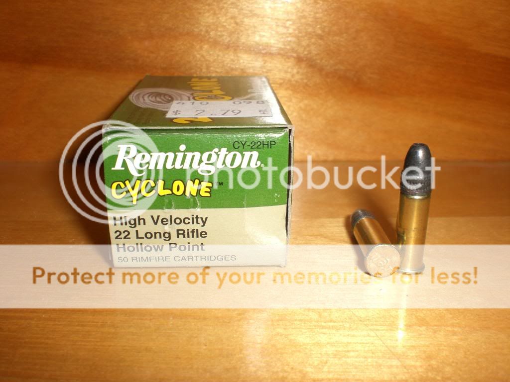

REMINGTON CYCLONE
average group size .75"
velocity
average 10 rd string 1279 fps
high 1282 low 1278
notes
what can i say besides i was blown away. i actually had to shoot two targets worth of this ammo to make sure my chrono wasnt malfunctioning. the first ten rounds had a 1 FPS deviation. I honestly didnt think that was possible in the real world. the second test left me with a 4 FPS deviation. i guess ill take that! the bore was clean and there was a small amount of smoke when shooting. the group size was a surprise because while i was shooting, the rounds seemed inconsistent and off in ignition. both targets i shot measured the same ( i had 1 called flyer on each target). This is currently the top dog for group size and velocity variation both and it will be a tough row to hoe for the remianing contenders to beat. the fact it is one of the cheapest cost per round contendors yet doesnt hurt either.
cost 2.49/50

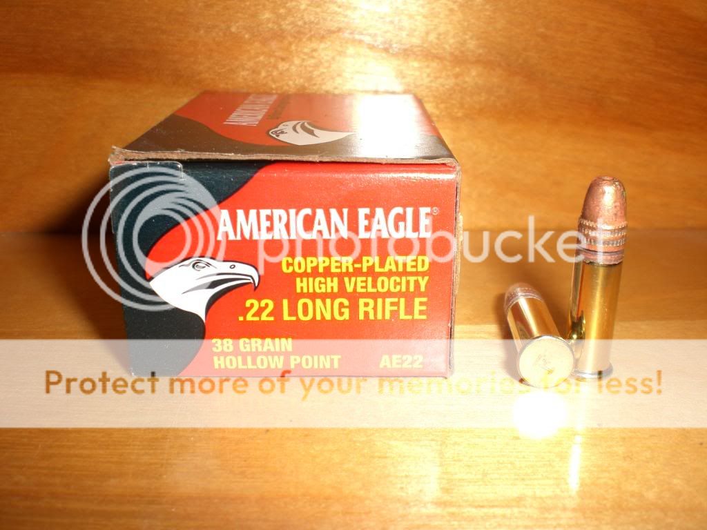

AMERICAN EAGLE HIGH VELOCITY HP
38 ge copper plated HP
average group size .95"
velocity
facotry spec 1260 FPS
low 1220 high 1300
notes
the most accurate ammo of the night, but velocity varitions hamper it from its
true potential. clean shooting.
cost 2.10/40
