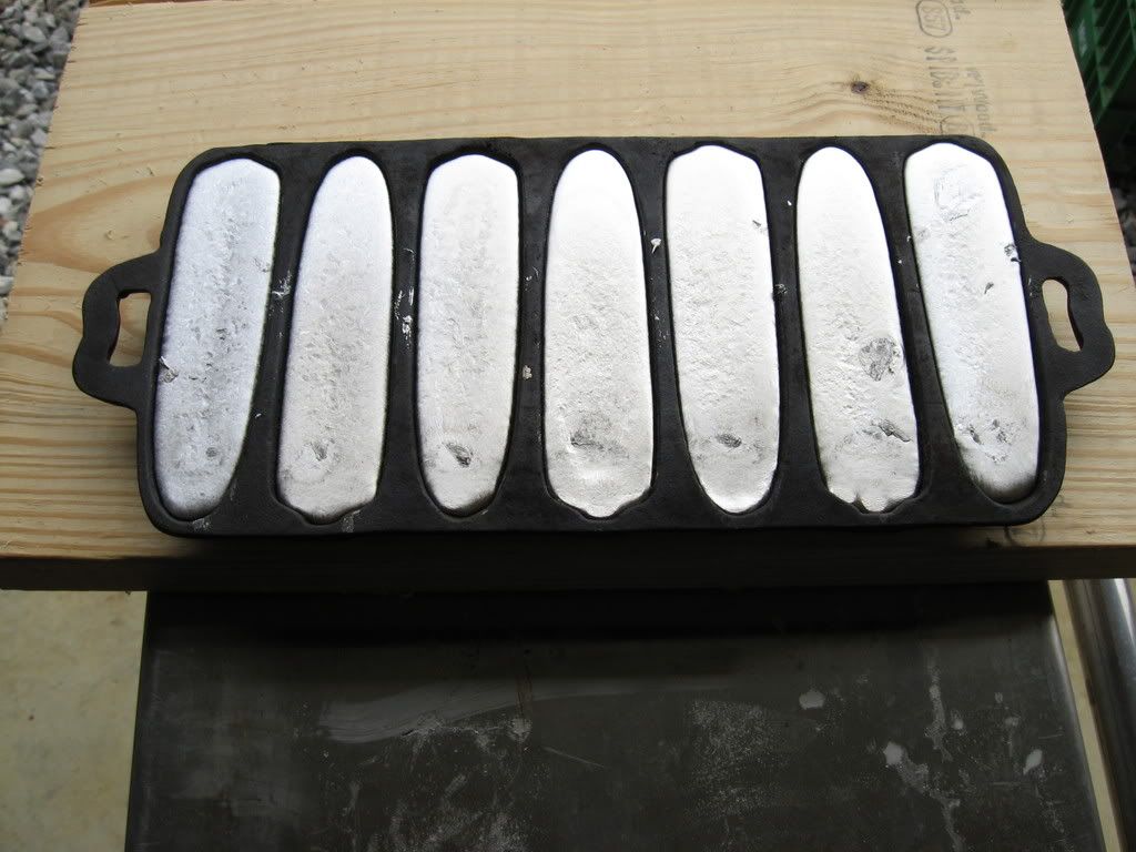

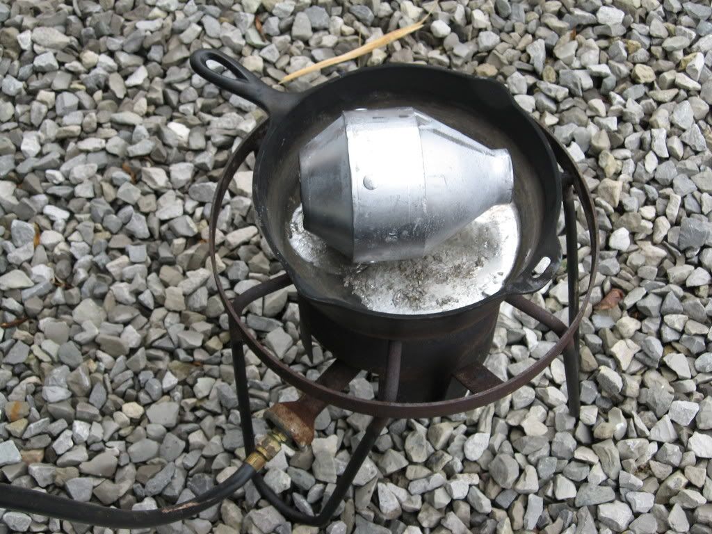

Still waiting on my backordered casting and reloading stuff. I'm passing the time smelting lead and casting ingots that will fit into the Lee casting pot. Have a good source of free lead. It comes in 30# chunks that I melt and cast in a cornbread mold. 98 ingot weighs 20 oz each or so, which gave me a pour of 120# this morning. This gives me 260 pounds made into ingots so far.
Took about 2 hours to make these and clean up.
Looks good man. Those cornbread ingots are great for sliding in the Lee pot when you're casting boolits.

This stuff is really clean when I melt it. After fluxing with wax I only get about 1 tablespoon of dross off each 30# chunk.

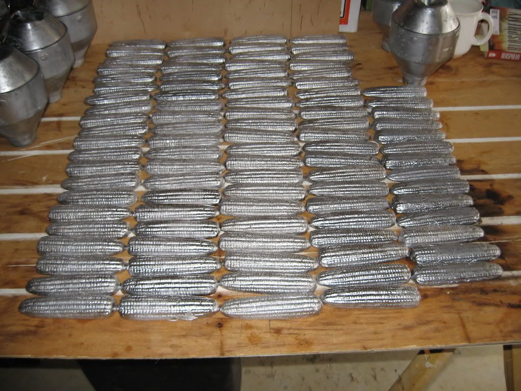

Photos of the results of my 1st weekend casting session. I am rather pleased with the results. 400# of nice and clean ready for the Lee bottom pour casting pot ingots. Since it doesn't look like I'll be getting my mold anytime soon I'll probably just keep making these to scratch the itch.
Note the slipper garage floor was to cold for bare toes.
Casting in 203g this should be enough to make 12,173 bullets. Not real sure why I'll keep making ingots unless it is almost as addictive as Hi-Points?
Dude, it's just fun. That's a crap ton of lead dude. I wish I had that much.

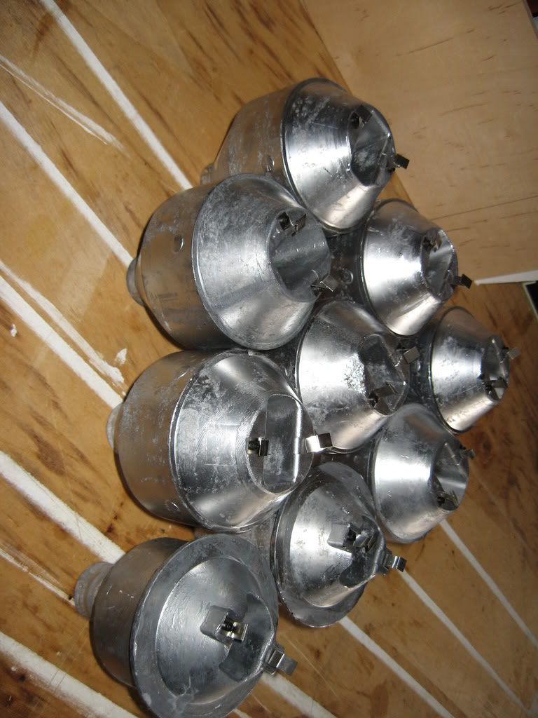

The chunks are 30# lead generator cores that are used to shield nuclear medicine isotopes during shipment from the manufacturer to the end user. They are lead alloyed with tin and maybe some other stuff. Test at 13.0-14.3 BHN that is plenty hard for most pistol shooting. I read that I could water quench to make a harder bullet but don't see the need to. Good source for me since I can get my hands on a couple hundred # every week.
