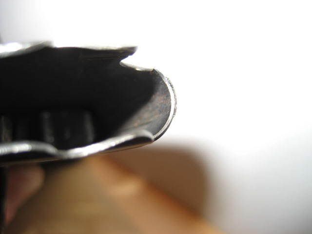

Thet were FTF issues. When back in the house i tried manually pushing them out of the mag with my thumb. The flat edge of the Hornady bullets nose is catching the forward edge of the mag. I bought some Corbon Powr'ball 100grain +P and tried the same thing. The tiny joint between the jacket and the ball in the nose was also catching at the same point on the mag.
I unloaded everything and looked closley at this point on the mag. The metal is obviously machine punched and before and after production not muck was done to clean up the machine cut sharp edge. I wsed my dremel and took a very little but off the inside of the mag along the curve. Then with the dremel and polishing compound I polished the surface i had shaped. They go through like a hot knife through butter.

I was able to fire a full mag with the Corbon Pow'r Ball 100 grain +p and they all ramped up nicely. The first pic shows where I ground a slight "ramp" on the inside nose of the magazine. I then polished it. The second picture is ....well I don't know exactly what it is but it was one of the Corbon rounds. All ejected ok. The last pic is a side by side of the Corbon and a WWB round notice the Corbon is a little shorter. Oh by the way I have also removed the factory "finish" on the receiver's feed ramp and polished it. Shoots great!!!
