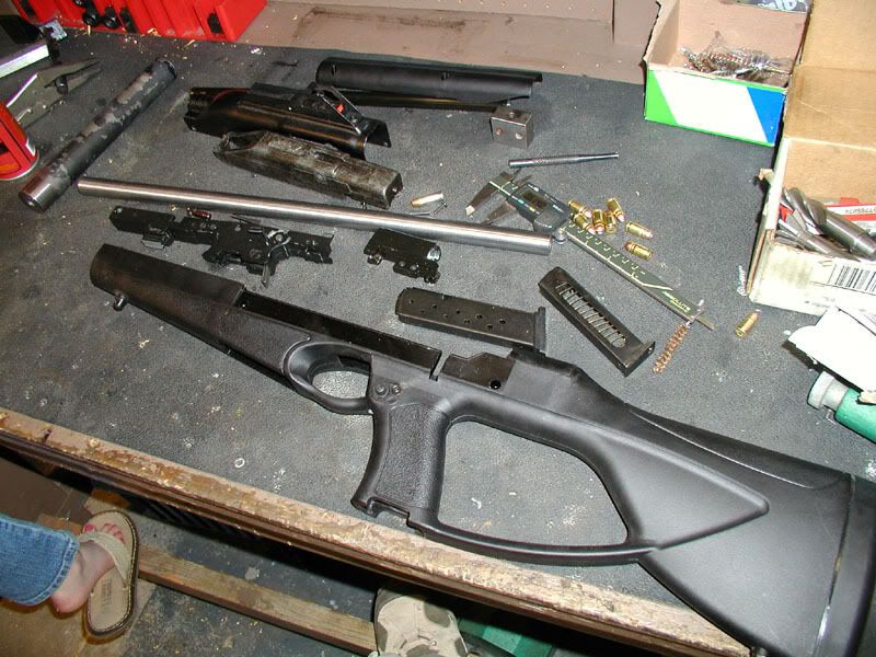

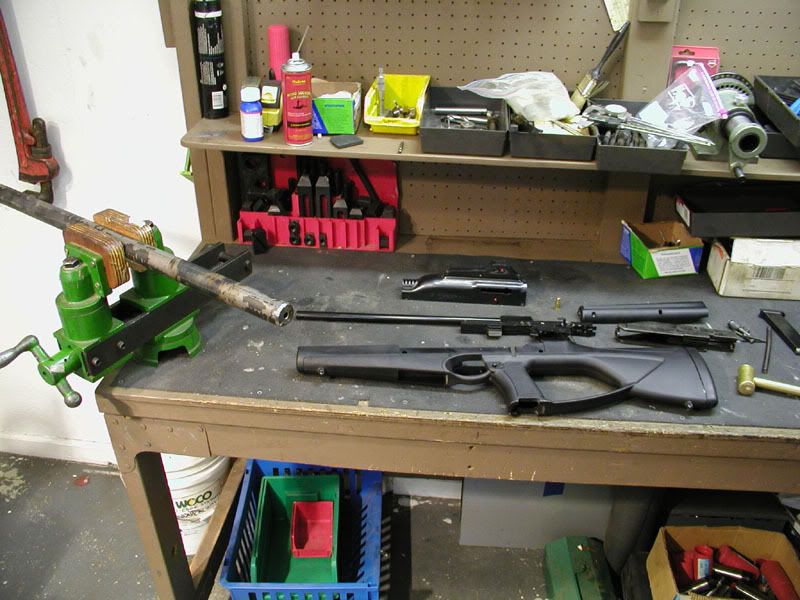

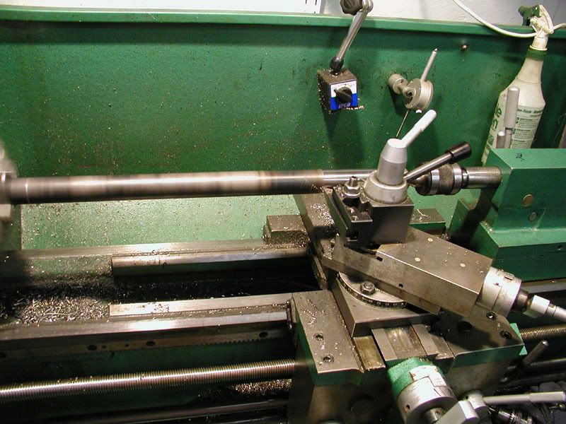

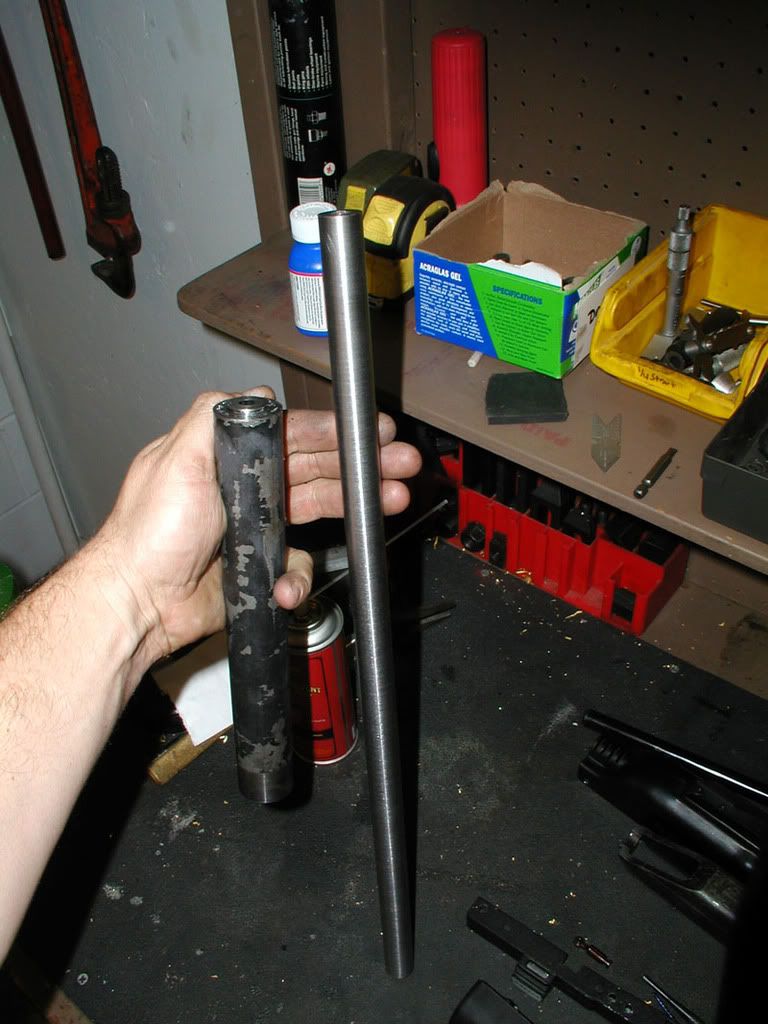

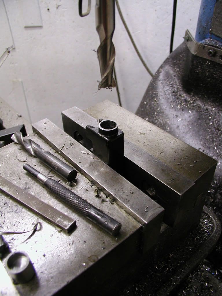

    Finally its almost done. 995 converted to 32 N.A.A. its going to be a real bottle rocket. Shilen 7.65 barrel blank 1/10 twist. Finished barrel to be 16.5 inches, target crowned and ported. Fires and cycles the bolt with no problem. We need to tweak the mag some for proper function. Maybe add a full length shim and spring change. A custom made scope rail is in the works. A fixed 4X will ride on top. Final finish will likely be a matte hardchrome. Chrony and gelatin test to follow. All work performed by a pro smith.

    Cost effective? Hell no. I needed a inexpensive reliable platform to start. The 995 fit the bill. There is no other 32 N.A.A. rifle or carbine I know of. And believe me I've looked. This may be the first of its kind. I just could'nt leave this one alone. I do own a converted East German Makarov in 32 NAA, built by the same gunsmith. I think you'll agree he does nice work.
