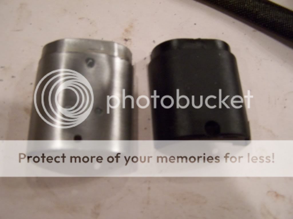

Cover was chipped and didn't come flush with the butt stock. Got a piece of 22gauge from home depot for under $10 and use d my vice to bend, painting it now, fits betterthan the plastic cover

hah, my brother is buying a 995 next week and asked me if I made two of these covers, 1 for him. Might make a few and see if there is any interest. Here it is after paint, it is way stronger than the original plastic piece. :devilsidesmile:

Created a template on paper with the original plastic cover, cut 2 pieces of metal, bottom one slightly smaller.
marked the section that remains flat in the center
, place edge in vice and gradually started forming the curve, moving the pice further into the vice to round the edge, then comparing to the plastic piece. actually it wasn't that hard , if I bent to far, jjust backed it up and flattenned with the vice. do the same for the bottom piece, and spot weld together with a 110 volt spotwelder from Harbor freight.

It doesn't look like you countersunk the mounting screw hole like the original ATI part is. If you can, I think that would be a good idea.
I countersunk it slightly but then used a much longer screw that went in deeper for strength and it was a allen screw head but didn't have a flat head like the original mini screw. I'll need to stop in Sear hardware and get a flathead screw . very observant! thanks
