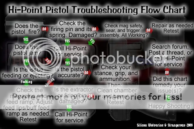

Everything cannot be covered in a 640x426 flowchart, however I think it will cut down on the repetitive "it jams", "fails to feed", and "fails to fire"... which are the most reposted/reanswered questions we get.
+1 to SW!
And you can always refer to the "Did this chart remedy your issue(s)?" box... and go from there!

I think it could be improved if you changed the "is the pistol accurate" to something like "Accuracy Problems or Other" then break off into accuracy and the other would lead to "Call Hi-Point". That would also flow better since the chart is supposed to be for the carbines as well.
I just bought a new C9. At the range, I couldn't hit the broad side of a barn at 7 yards. I normally shoot an XD9 very accurately. Given this info, using your chart, I never get to "shooting accurately" because the gun jammed both ejecting and loading. I follow the chart and skoot right past accuracy to jamming. I understand that the gun needs to be broken in more. I only fired 50 rounds through it, but 10 of the rounds hung going in or out. I hope this helps in refining the chart. As an added interesting note, after I bought the gun as new, I found my initials (coincidence!) carved into the bottom of the magazine. It leads me to believe it was previously sold and then returned. Go figure...
I do fire one handed, weak side, due to a stroke I suffered a few years ago. Any thoughts on my experiences with the gun? Thanks ^-^
19,454 Posts
your jams are more than likely due to limp wristing the pistol. grip it firmly and hold it steady and see if your jams go away. letting the gun bounce around too much can cause problems. the way you describe shooting it may exacerbate the situation.

If your pistol needs more "breaking in" loading the magazine for a couple of weeks. If that doesn't break the magazine in good enough try only loading 7 rounds, or so, until it in broken in. A far as accuracy is concerned, I can't speak to your experience because it seems atypical to me. Even if you do get the feeding problems worked, If you are able to shoot other pistols accurately and can't with the c-9, I would send it back and get them to figure out the problem.
