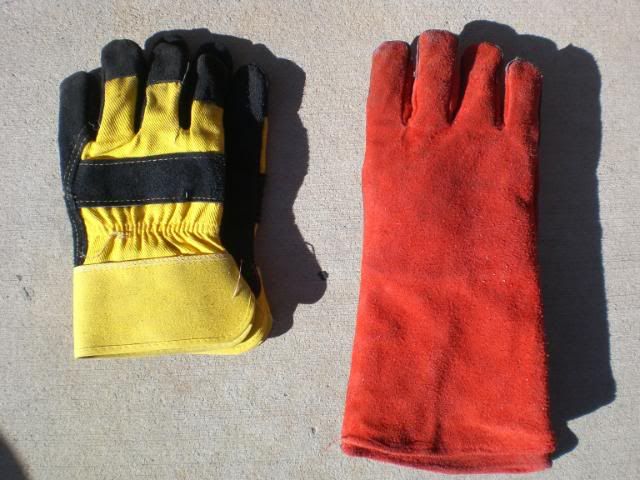

Now that we have the heat we are going to need a good pair of gloves!!!! I am using a pair of leather work gloves and a set of Welding Gloves. Make sure they are thick or your hands will get hot in a hurry.

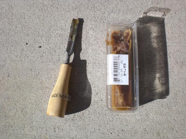

You will also need to get a Flux of some kind. I am using Lee bullet lube for this. You can use bees wax, and I have heard of some people using saw dust?? I use the Lee Bullet Lube just to keep it simple for me. What ever you use make sure the it does not have a corrosive in it or it will rust your pots in a hurry. There are many brands out there a quick Google search will find you many.
