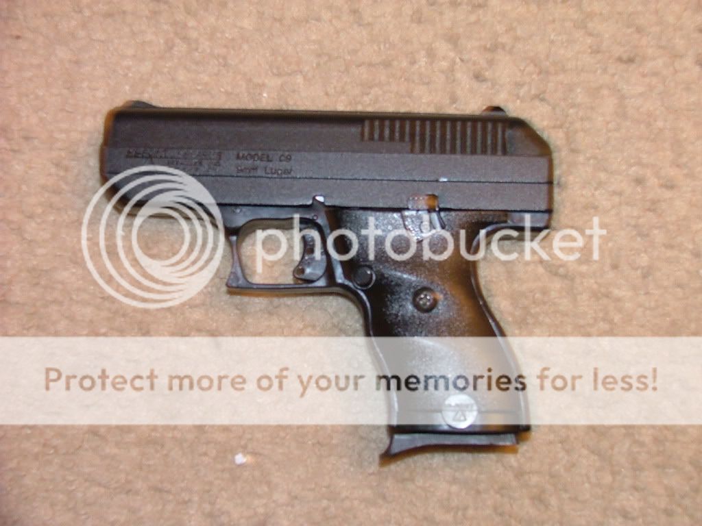

This is what I started with. Bought used and was sent to Hi-Point for a safety check.

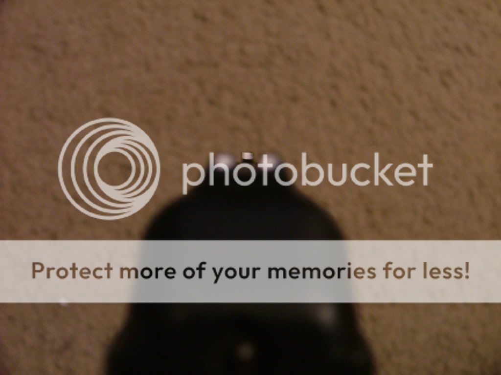

First part I did was paint the sights.

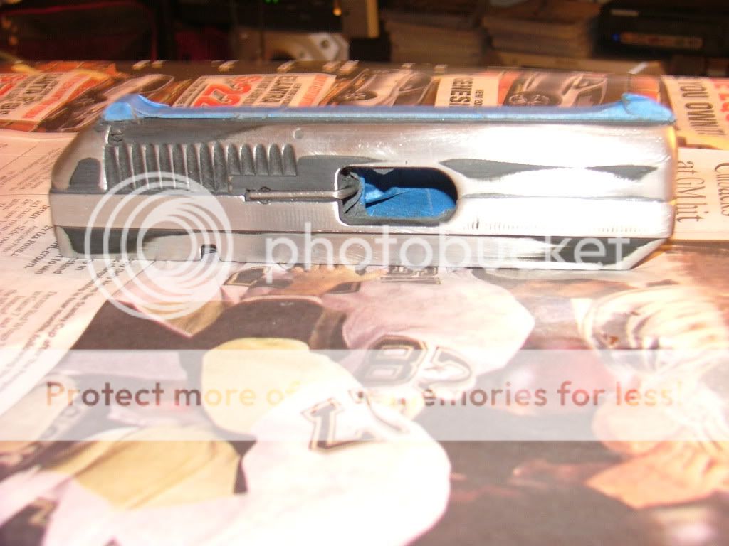

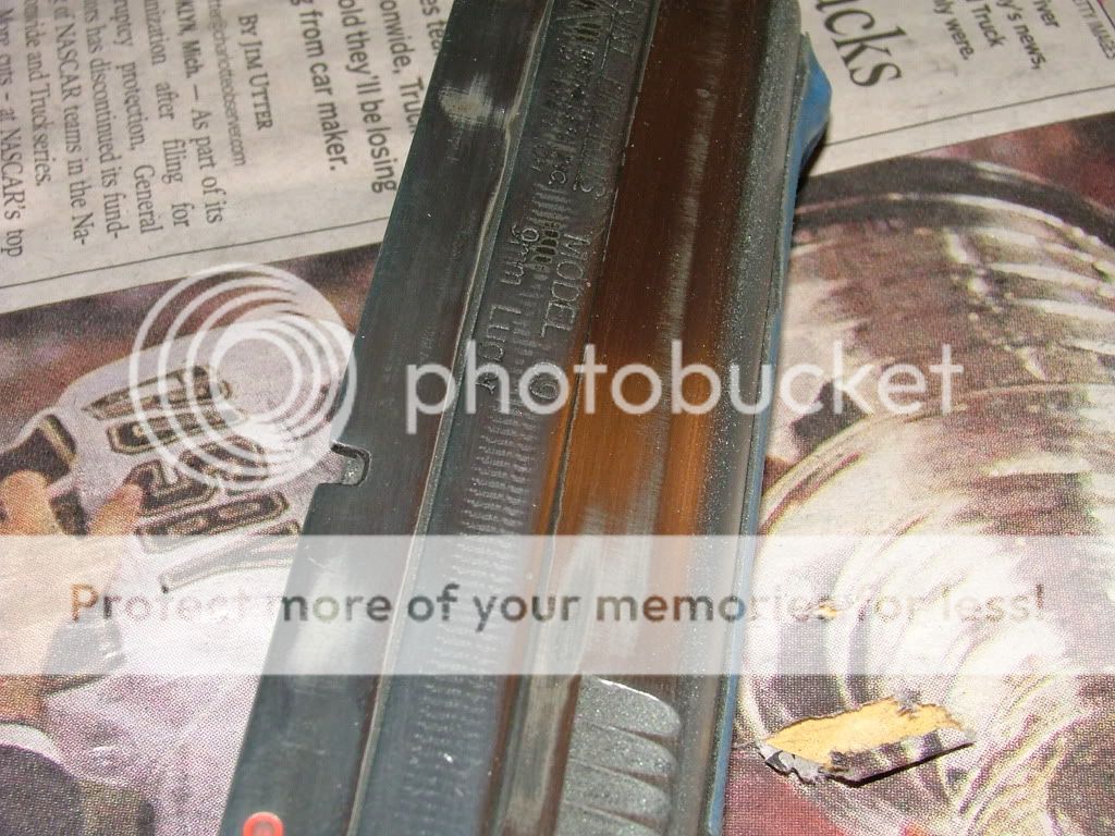

the next part was to sand off the powder coat. I did not have a dremal so I had to do it by hand. This is how half of it looked after an hour and a half.
This is how the slide looked after 3 hours. Almost all of the powder coat is gone. That stuff is hard to take off. It's almost like Hi-Point does not want it to be taken off.
Here you can see how easily the bare metal can tarnish just after just a few minutes. The shiny part is the freshly sanded part and the dull part is the spot that was done 30 minutes before.

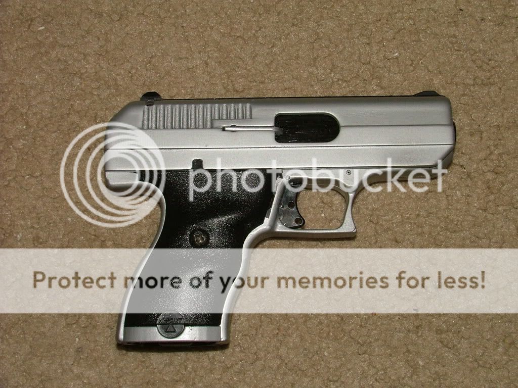

Here is how she looks all put back together and with the frame painted.
Opposite side.

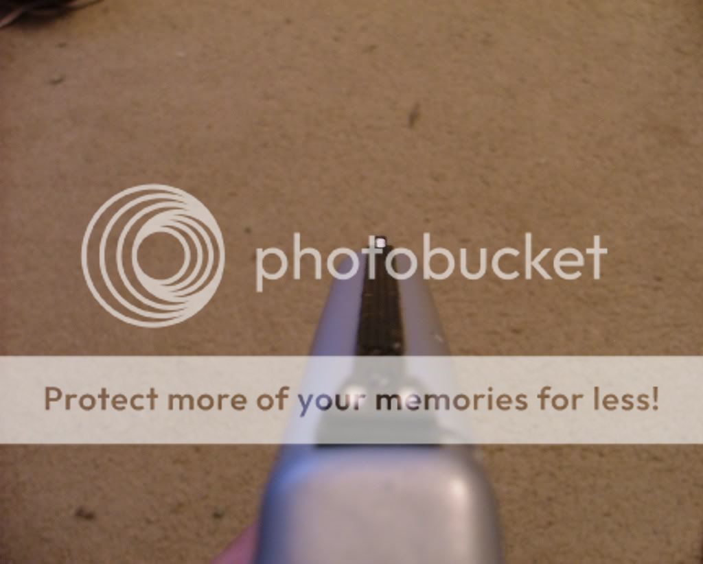

Another look at the sights.
