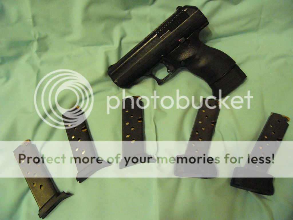

Ok so I orderd these on Monday night on their website and I got them Wed :shock: fast isn't the word ...maybe lightning :wink:
Oh and I put innertube on the mags for grip :!:

All you need is a dial caliper or digital.. and needle nose plyers and maybe some 500 grit sand paper for polishing.

I prefer the consistancy of mine. It was hanging up like yours and every once in a while dropping the mag fully. I took the right grip off, carefully so as to not lose the little screw, and removed the mag lockout. I wanted to keep the function for safety, but I knew that it was puting too much pressure to allow the mag to fully drop, so I filed the rounded part of thelittle devil smooth and shiney. It works like a champ now. It drops the mag right into my hand when I hit the release. I would say it drops easily enough to be quickly reloaded for competition. Just file it a little at a time and see how it works. A good frame of reference is when the black paint comes off of the round part, check it.
