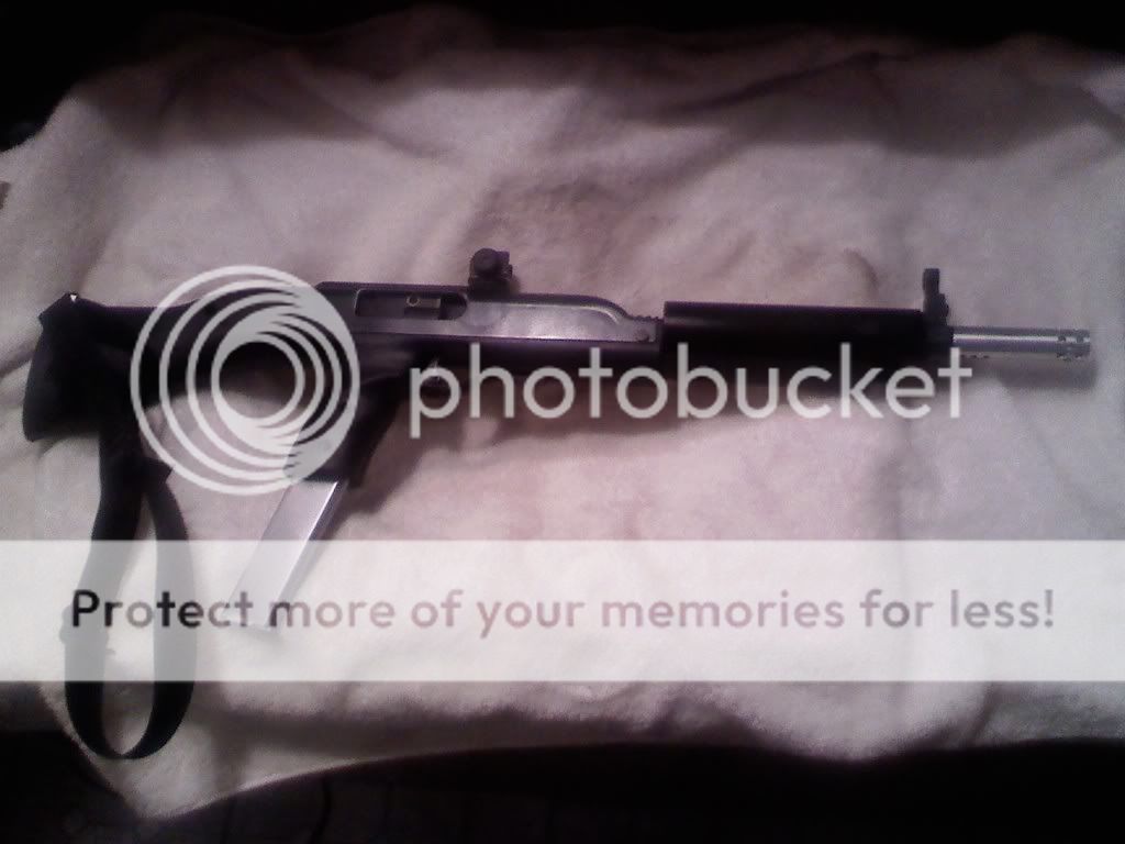

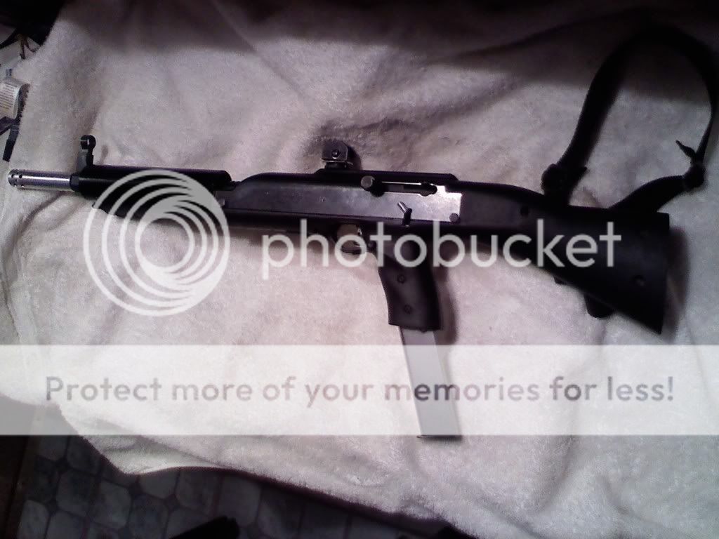

1st post. bad pics but what do you think?/
Its got a home made muzzle brake (still needs paint) and barrel shroud with rail and cover on bottom, 17 rd. mag, AR-15 A2 rear sight, factory sling in single point position, barrel cut down to 16.25", and 3.5" inches cut off the buttstock. Got it sanded down and filled with silicone but still need to make butt pad still.
Any one else out there with a custom .40?

Pretty neat, I really dig the extended mag. Is that a muzzle break or a flash hider?
Discussion Starter · #16 ·
Re: New guy with a 4095.
Just a muzzle break. I originally made it to thread on to my .22s and AR but commercial ones look better. So I bored out the threads and mounted it on the 4095 with set screws. Still haven't decided if I want to paint it yet.
