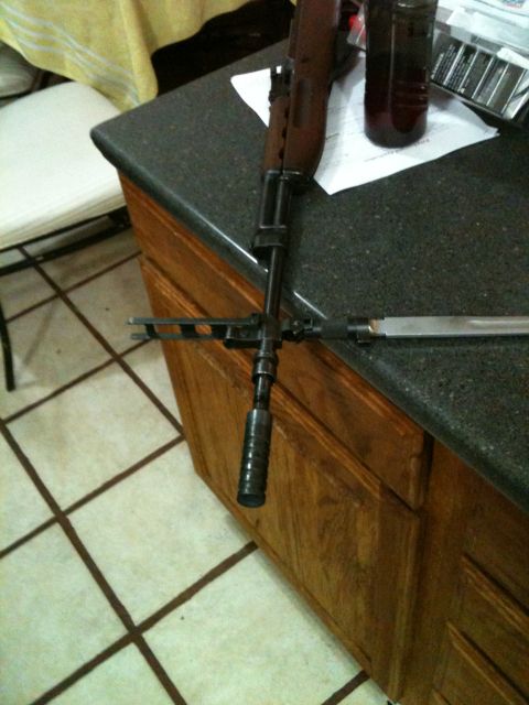

Pop the pin out, then torch it, (read lots of heat) and then spin it of counterclockwise. You'll actually see the adhesive they used on the threads burn down and catch as yellow flame. If its on there tight you may need to use a vise so as not to bend the barrel. I didn't need that. I applied the heat until no more of the adhesive (I kept wiping it away) could be seen coming from the launcher and then torqued on it a little bit and it popped loose. I did it at the kitchen table. No problems. Just don't burn yourself.What is the best method to remove launcher from yugo sks ?
