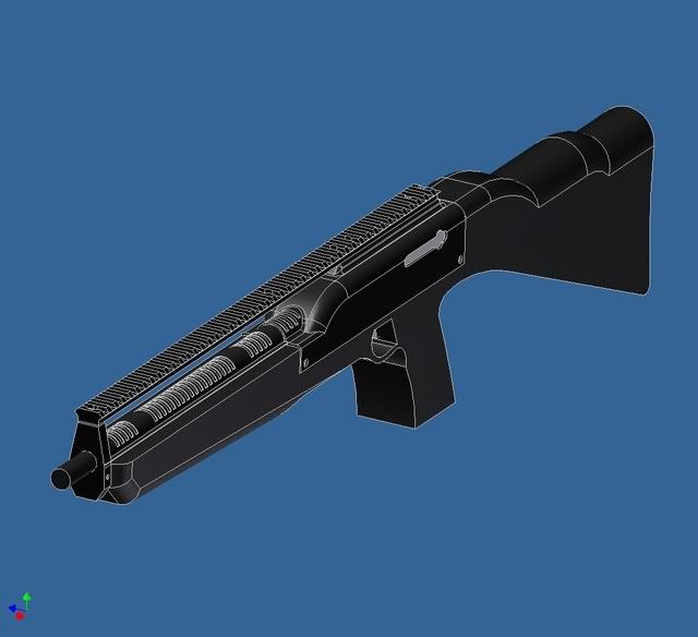

Would you guys be intrested in being able to buy some picatiny pre-drilled for all 4 screws on the top of the guard?
If there is enought intrest, I'll buy some stock picatinny and cut, dirll, and counterbore. Lets say for about $15. Raw aluminum.
Funny you bring that up, cuase that was gona be my next post.
So 3 products to be made are:
* Short pre-drilled rail (same size as original stamped rail)
* Long rail and mount that will fit the original stock and hold the heat shield down.
* Long rail that will fit the ATI

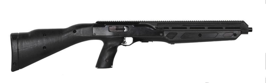

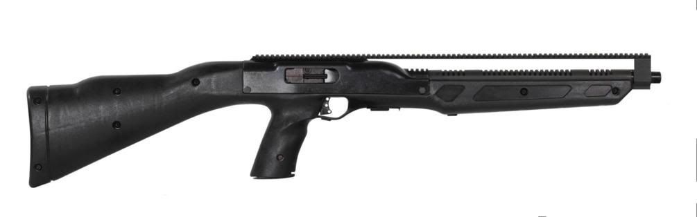

Griff:
You definitely need something on the front to brace the rail... but yes it does not have to be that heavy duty. Probably 3/8" plate cut in a complimenting shape. Held on with a set screw or two. Even though that clamp style is much nicer, it is alot more difficult to do.
Yes, I know the stock looks like crap, but use your imagination. Also, notice that front support looks alot like the quad rail mount... thats cause it is. In case you buy this and later decide to add the other 3 rails. The rail also has the hole for that second mount, if its ever needed.
And for those I-dont-want-to-void-my-warranty guys, nothing is modified, its completely removable, and the weapon stays on the original stock so you won't run the risk of "overcompresing your springs". :roll:

Very intresting... not too keen on the skeletonized stock, but the front looks nice.
Its a camera phone picture.
Its called support and co-witness.
Full rail offers support (on some guns) and heat desipation. but most importanly you can mount a variety of steel sight and holo scopes and have the ability to co-witness (see through both of them).
Oh yeah, they look COOOOOOOOL!!!111
I think you guys are talking about different stocks. One of the new HP stock and the other one of the PhotoShopped stock.
