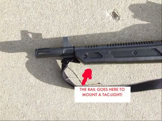

Easy ....a 4" rail 2 screws and a tap and die ! i aready looked at it and i can be done!
OK duke, you can either do that or short rail, with 4 drilled thru holes for #4 socket head cap screw with counterbore (larger drill to clear the head).
That way you don't need to tap anything... unless you want to.. in that case use a #6 tap because the holes on the top of them shield are precisely the drill tap size for a #6-32 thread. This is how I attached the top rail for the quad rail prototype.
If you want me to make you one, just PM me. Price should not be too much.. .maybe 10 bucks plus shipping.

Well, I'm talking about replacing the stamped rail on the top of the gun with a milled aluminum rail. Same length and same hole pattern to keep the installation simple.
I'd be down for that, or for the full length for my ATI stock. I had a Beretta CX4 toprail from a friend, but it would need a filler piece to cover the difference between the receiver cover and the front-top of the ATI. I did use the front tri-rail, and that fit PERFECTLY, a good $20.
HERE IS A PIC TO CLEAR UP THIS WHOLE MESS! ( and a thanks goes out to bushman for the awsome flash hider!)
