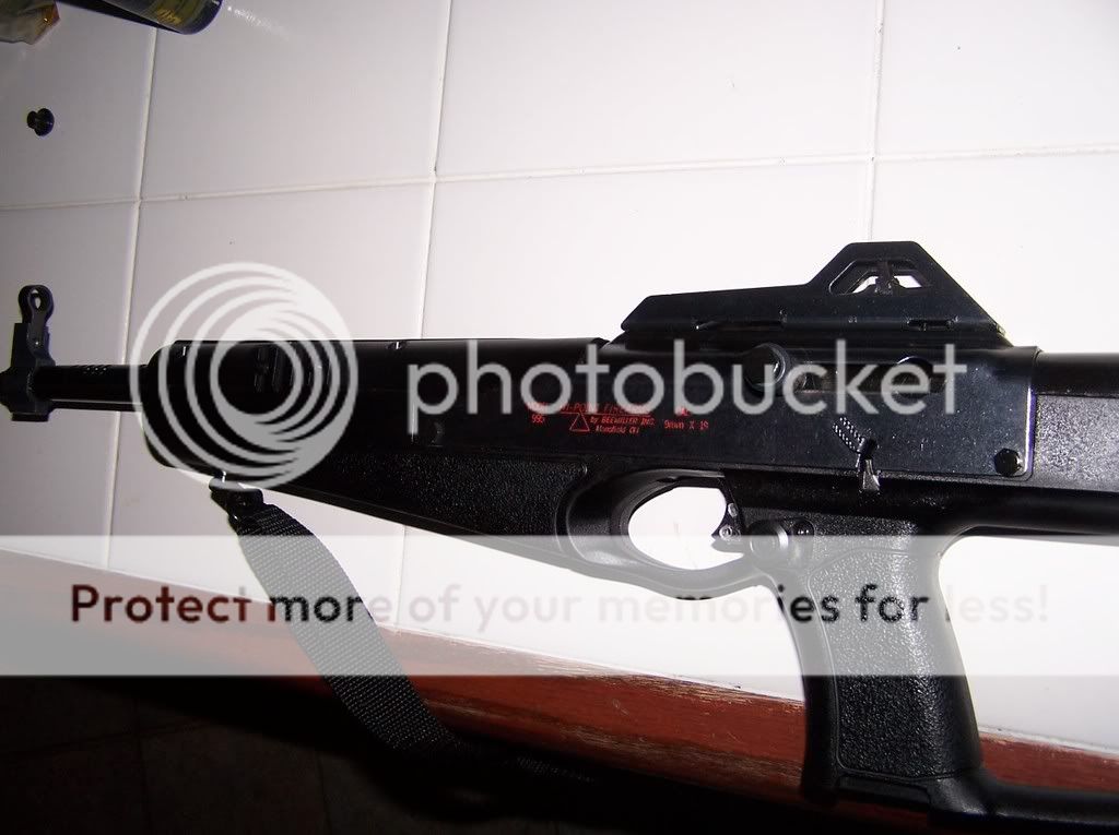

I used the Norells over a blued receiver (below) and it came out great, It made it much darker black and smoother as well. I was thinking about putting a coat over my 995 receiver also since the bluing is light and the metal is rough. I have used it on the hex bolts, bushman trigger and fabricated receiver cover plate so far.

is that half an ATI stock you have there?
It's a full ATI stock but I cut out a pocket to keep half of the original barrel shroud cause I like how it looks, THe receiver cover plate was chipped so I made one out of 22gauge sheet metal from home depot.

WOW, that looks REALLY nice. Great job!!

AKM. How did you paint just the writing on the side of the receiver cover (red)?
You just take a red grease pencil availble in most hobby/craft stores and scrible over the area in all directions, then take a clean rage and wipe back and forth over the whole surface until the raise portions are clean...looks pretty good when you're done. :cool2:
